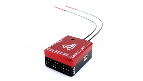

Spirit W1 and Spirit W3 are stabilisation units for R/C aircrafts such as helicopters and planes featuring control unit and receiver in one extraordinary packageǃ
It combines the best available technologies from both worlds to offer cutting edge experience.
In other words, Spirit W1 consists from Spirit GT hardware and Spirit Wave receiver.
Control part
  • Top-notch 20-bit IMU Sensor
  • Performance-line ARM F7 processor
  • Precise pressure sensor for Altitude measurement
  • Dedicated Memory Chip for detailed logging
Receiver part
  • Spirit Wave 2.4Ghz full-range telemetry receiver
  • Full featured 30+ channels available
  • Blazing fast 300 Hz transmission
  • High interference immunity
  • BEC Voltage measurement
Spirit W1/W3 can be easily bound with all Spirit Wave radios. It can be used also with all third party external receivers known to work with Spirit units.
This will allow easy transition from previous systems, while Wave radio can be linked anytime later.
Following pages are covering setup of your Spirit Wave radio and W1/W3 unit to prepare everything for the first flight.
When W1/W3 unit is used with a non-Wave radio you can proceed according standard Spirit manual.
