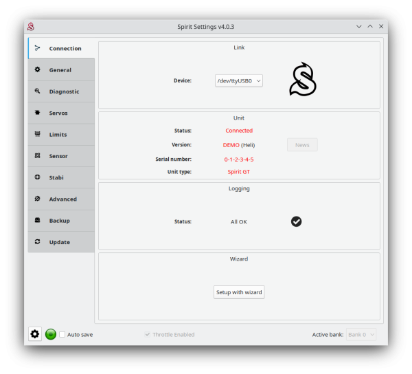

5.1 CONNECTION TAB
This tab indicates the current status of the connection, informs you about the current version of the firmware, displays the serial number of the connected unit and allows you to change the COM port. In addition it features a wizard for initial setup.
We recommend using this wizard, as it will guide you through a basic setup in the easiest and simplest way.

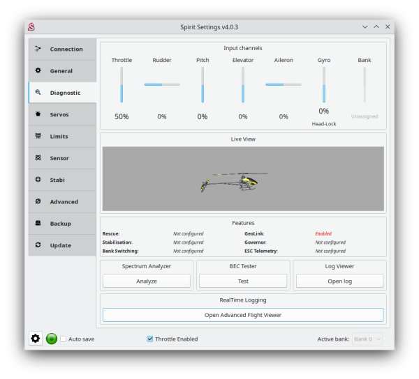

5.3 DIAGNOSTIC TAB
Once the settings in the previous tab have been completed, it is now recommended to make any adjustments and changes required in the transmitter so that the transmitter controls match the displayed system's outputs. Generally, each transmitter is different and the center of the channel is never exactly the same. Wear and environmental influences can also have an effect causing the center of the channels to fluctuate. Another consideration is the maximum and minimum value of each channel. Here, you adjust your throws using your transmitter's servo endpoint adjustments.
Info.png For a proper operation of the unit, it is necessary that movement of each channel correspond with the bars. Direction of the movement must match with the sticks as well.
Secondly, it is necessary to check the values of aileron, elevator, pitch and rudder channels. These channels must be centered at approximately 0%. The unit automatically detects the neutral position during each initialization. Do not use subtrim or trim functions on your transmitter for these channels, as the Spirit FBL unit will consider these as an input command.
Ensure all subtrims and trims are zeroed.
It is also recommended to set the maximum and minimum values. Test the minimum and maximum throws for all channels, if these values are not equal to -100% and 100% in the diagnostic tab it is necessary to adjust your transmitter endpoints to correct this.
After these adjustments, everything should be configured with regards to the transmitter. If some channels oscillate around the center, it may mean wear of the transmitter potentiometers. This can be compensated for by increasing stick deadband in the Advanced tab. (Covered later)
If the values in the aileron, elevator, or rudder channels are shown in bold, the system is recognizing a command to move/rotate the axes.
To determine Gyro Gain and Mode of the rudder gyro you can check Gyro bar.

All reviewed logs are saved as PDF files into Documents directory.
5.3.4 REALTIME LOGGING
Spirit GT and Spirit GTR units feature Advanced Flight Logging capability. It is possible to record all variables and store hundreds of logs in embedded memory, view and share all data in a great detail.
See page RealTime Logging for more information.

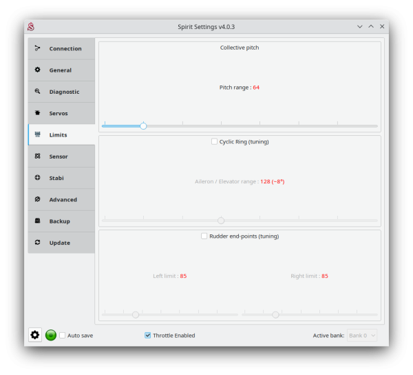

5.5 LIMITS TAB
This tab affects limits and servo travel ranges.
Cyclic Ring (tuning)
This parameter sets the electronic cyclic ring, which allows the model to achieve the largest cyclic ranges without mechanical binding (binding of servo horns, pushrods and linkages).
Info.png The settings here should be done very carefully to avoid damage to the model or it's associated electronics. Never exceed recommended angles by manufacturer of the model, otherwise a boomstrike can occur.
First, set your desired Collective range, for example, +/-12°. We recommend using a -100% to 100% linear collective pitch curve in the transmitter. Now it is time to set the Aileron/Elevator maximum cyclic pitch range.
Try to set the largest possible deflection. Generally the Cyclic pitch angles (range) should be equal or lower than Collective pitch. This parameter does not directly affect the speed of rotation, but if it is too low, the model may not have consistent pitch and roll rates. The setting should be done with 0° collective pitch. Then carefully move with sticks in all directions to ensure that mechanical binding does not occur. This should also be done for the maximum and minimum Collective pitch.
If you increase the collective pitch range, this parameter must then be checked and in some cases adjusted to ensure no binding occurs at your new maximum and minimum pitch ranges. If the selected cyclic ring range is insufficient, it is possible that pitch-up can happen during fast forward flight (even if the pitch-up compensation is at its maximum value). This is because the model will not be able to add sufficient corrections with the configured range.
Rudder end-points (tuning)
Left / Right limit - Sets the minimum and maximum deflection of rudder rotor blades. We recommend setting these values for both directions to the maximum allowed range by the manufacturer of the helicopter. Otherwise, the rudder may not be able to keep the yaw direction during demanding maneuvers and tail blow outs may occur. Do not exceed allowed limit for your model.
Info.png Micro helicopters and µSpirit: When Tail rotor is driven by a dedicated motor, the Rudder ESC must be connected at the CH4 port. Rudder end-points are then used to set available Throttle range for the Rudder ESC from 0% (Stop) to 100% (Full). We recommend to set Stop limit to 126 and Full limit to 150 for the beginning.

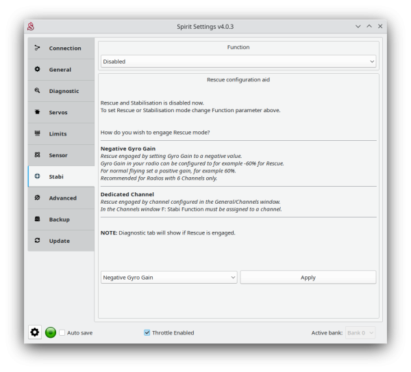

5.7 STABI TAB
The Spirit unit offers you the options of model stabilization and rescue mode.The stabilization function, once activated, will recover the model to a horizontal position without any other input from the pilot, this can be used as a “bail-out” feature when trying new maneuvers and can help with the learning process.
Rescue mode complements the normal operation of the Spirit unit. If activated, the model will recover to a horizontal position and add collective pitch as per the settings. This function can be used any time when the pilot loses orientation or control of the model.
As soon as pilot will disengage the rescue mode full control is regained immediately.
Stabilisation mode will maintain horizontal position of the model once sticks are released. Making flying very easy. Different behavior is available within our stabilisation modes. Collective pitch steering is unaffected with stabilisation.
How to setup the Rescue or Stabilisation is described in the Stabi mode page. There is also Setup Wizard for the Rescue available directly in the Spirit Settings. See Stabi tab when Function is set to Disabled.
You can activate selected Function by two different methods:
  • Negative Gyro Gain
  • Dedicated Channel
Negative Gyro Gain method is suitable for radios with low channel count (6 - 7). When you have available unused channel, method with a Dedicated channel is better and easier.
Currently selected mode is displayed in the Diagnostic tab.

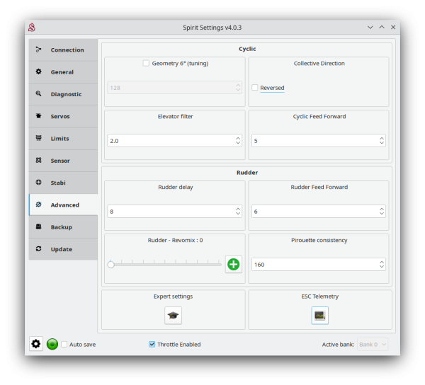

5.8 ADVANCED TAB
This tab is for more advanced configuration of the Spirit FBL unit. It is recommended that you fully understand these parameters before adjusting them. However, it is essential to set geometry. Other parameters, however, depend on the preferences of the pilot.
Geometry 6° (tuning)
For proper operation of the Spirit unit, it is necessary to set this parameter correctly. Here, the unit is switched to a special mode for settings 6° of cyclic pitch on the main blades. It is necessary to set the value so that the blades angle is at 6° in the aileron axis. You need to rotate your rotor head with blades to be parallel to the longitudinal axis of the model. A higher value increases the angle; a lower one decreases the angle. Optimal head geometry should be in the range of about 90 – 160. If not in this range, it is recommended to adjust the distance of a ball link on the servo horns or perform other mechanical adjustments.
Collective Direction
Parameter to determine direction of the collective pitch. In case of a Trailing Edge rotor head or if a mixing arms are present on the rotor head, tick the Reversed option. In the most cases the parameter is unticked.
Info.png Correct configuration is very important, else the collective pitch will be reversed.
Elevator filter
This parameter compensates elevator bouncing during aggressive maneuvers. The larger the value, more compensation is involved. If this value is too high it can lead to a soft feeling in the elevator. We recommend using the default value of 1 to begin with.
Cyclic feed forward
This parameter is used to set amount of direct feel between your sticks and your model helicopter. The higher the value, the more aggressive the model will feel and the faster the model will react to stick movements. If the value is very high, elevator bounce-back effect can occur. During a tic-toc maneuver you can also observe higher motor load or aileron oscillations, because the model is unable to react fast enough. Setting this value too high can result in elevator bounce. If the model feels disconnected and there is a lag between stick inputs and the model, try increasing this value.
Rudder delay
This is parameter to smooth out a rudder movements. It also helps to stabilize the rudder – it is a kind of electronic damping, similar to a derivative term of regulation. The faster the servo is, the lower the Rudder delay should be. For analog servos it is recommended to set this value to around 20 - 25. For slower digital servos it is mostly between 10 - 15. For fast servos (~0.04s/60°) the value is around 5. In case of a brushless servos it is recommended to set the value of 0 - 2. If the value is too high, the rudder could start to oscillate, wag or it could cause too smooth rudder stopping.
Rudder dynamic
If the rudder does not stop correctly, for example it overshoots, this behavior can be changed with this parameter.
6 – is the default value.
The larger the value, the more aggressive the behavior of the tail. If the tail overshoots in stops, the value is too high. This parameter also affects the response speed of the stick movement; a higher value means a faster response. If you cannot reach a symmetric stop on both sides you will need to make sure that the tail is centered at 0°. Alternatively, you can lower the rudder limit for that side.
Rudder – Revomix
Revomix (tail pre-compensation) adds rudder in response to collective pitch changes, when the tail needs increased holding. Revomix is independent of the transmitter. By default it is turned off, the user must set the amount required of the pre-compensation.
Allowed values are 0 to 10 with 0 being disabled; in most cases it is not necessary to use this parameter, however, when using low headspeed or on helicopters with a poor performing tail, this setting can be used.
Pirouette consistency
This parameter determines the consistency of pirouettes and holding performance. If pirouettes are not consistent during certain maneuvers, increase the value of this parameter. This value is individual for every model, it depends on many factors such as: your rudder mechanics, head speed, etc. Before setting this parameter, it is recommended to first set the gyro gains. If the value is too high, the tail can oscillate or wag. It can also cause poor stop performance. This value should be between 150 and 180. For brushless servos it is recommended to increase value by 10-15 points.

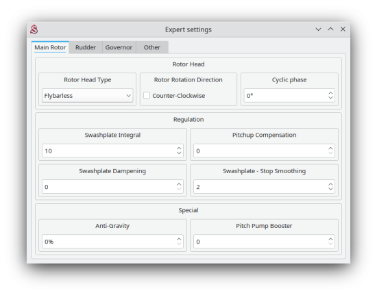

5.8.1 EXPERT SETTINGS
For fine tuning you can set the following parameters. Normally it is not needed to configure any of these parameters.
Rotor Head
Select Rotor Head type of your helicopter. Available options are:
  • Flybarless - for flybarless helicopters.
  • Flybar (Stablizied) - for flybar helicopters with flight behavior closer to flybarless - more stable.
  • Flybar (Pure) - identical flight behavior as without Spirit unit.
Rotor Rotation Direction
Parameter to determine rotation direction of the main rotor. In the most cases it is in the clock wise direction - parameter is unticked.
Cyclic phase
The value indicates the angle by which the swashplate is virtually rotated. For example a value of 90 will rotate the elevator to aileron. This feature is recommended for models with multi-blade rotor heads. For most other models, we recommend a zero value.
Anti-Gravity
You can equalize throw for a positive and negative pitch. So that pilot can feel it flys similarly fast up and down. With increased value pitch difference for positive and negative collective will enlarge. It also calculate such difference based on attitude of the model. When it is skids down Anti-Gravity apply in an inverted manner. In other words pilot will feel that the model is lighter in the air. Recommended rather for a smaller models.
Pitchup Compensation
For compensating unwanted helicopter tilting during a fast collective pitch change increase the value until behavior will disappear. This unwanted effect is mostly visible at the Elevator axis. With Pitchup Compensation you can eliminate this effect, however the value shouldn't be higher than really needed. Too high value will lead to overcompensating in the opposite direction. Value 1 will work well with the most models. Bigger models such as 700 - 800 class might require higher value. The most visible effect can be seen in a Fast Forward Flight while changing Collective Pitch quickly. Advanced pilots can see a benefit during pirouetting maneuvers.
Pitch Pump Booster
To achieve flybar-like collective pitch behavior, you can increase the value until desired feeling is achieved. Remember that higher values are too demanding for power supply and servos on the model.
Swashplate Integral
Integral Gain of the Regulation loop for adjusting precision and stability of the model during all maneuvers.This gain can change behavior of the model to a very big degree in terms of flight characteristics. Recommended to adjust only by very experienced pilots. For all other pilots we recommend to set value 9. Lower value will feel less precise and model will behave more natural - as a Flybar. High value can feel more robotic with extra locked in feeling. Difference can be visible mainly during strong wind. Too high value will lead to unwanted oscillations and Elevator bounce back during sharp Elevator inputs.
Swashplate Dampening
For reducing odd effects of too high Swashplate Integral, hard or slow mechanics pilot can increase the Dampening value. It is mainly helpful for sharp maneuvers for avoiding odd oscillations or a bounce back effects at the Swashplate. With this parameter you can achieve a crisper and precise Swashplate stopping. Recommended is to set the value only as high as really needed. Too high value will result in unstable behavior, because higher value is increasing decay rate of Integral. If no stopping issues are observed even with 0, it is recommended to leave at 0. Higher value will also reduce reaction time of stopping.
Swashplate - Stop Smoothing
After adjusting Advanced/Elevator Filter parameter to the highest value that works the best, you can improve Elevator Stopping performance even further with this Stop Smoothing. It will temporarily increase value for Elevator Filter but only during stopping maneuver..
Rudder - Control Type
With µSpirit units it is possible to enable support for the tail rotor driven by dedicated motor. In this case two ESCs are used, where Rudder ESC is connected at the CH4 port. Important thing is to set Limits/Rudder ESC - range appropriately since these are defining available Throttle range for the ESC from 0 to 100%. Normally this parameter is available in the Setup Wizard.
Rudder - Stop Smoothing
For making Rudder Stopping smoother, while maintaining crisp beginning of yaw rotation. It is recommended to first reduce Rudder - Stop A/Stop B before increasing Stop Smoothing parameter. This parameter is perfect for Low RPM setups or heavy/Scale models. Increase the value until you will achieve smooth stopping as per your requirement.
Motion Sensor Filter
Algorithm for motion data filtering.
  • Standard option for the most helicopters - Recommended.
  • Low Latency option for improving Gyro response to a motion allowing higher precision and better flight characteristics - available for Spirit GT, GTR, W1 units.
  • Strong option is for operating at helicopters with extremely high Vibration Level with no way of reducing them. Recommended only for Gassers, Jets or Nitro motors.
Stick deadband
Determines the area, around center stick, where the system does not recognize any stick movement. If channel readings are inprecise the value should be increased. This can be verified in the Diagnostics tab. This parameter does not replace the Exponential function. Recommended value is 6 - 10.
Stabi/Rescue Algorithm
Algorithm that can make Stabilisation, Rescue and GeoLink modes more precise.
  • High Precision for models with low vibrations - Electric models with smooth mechanics.
  • High Immunity for models with high vibrations - Combustion models.
Rescue - Smoothing factor
To reduce demand for model mechanics please increase the value. It will make a slower movements to reduce current spike and possible overload of the BEC/battery. This will increase safety of the Rescue maneuver, however too high value will result in a slower recovery.
RPM Sensor Filter
In case that your RPM sensor has noisy output then RPM readout can be very unstable. This can lead to various problems with Governor. There may be a problem with spool up, flight mode switching or head speed jittering. To make RPM readout very precise, you may need to increase the value. On the other hand, too high value can lead to a delay, that is unwanted for optimal Governor performance. So the value should be as low as possible while RPM readout is still precise. Variation of 1-20 RPM against the Requested RPM is optimal.
Autorotation Bailout rate
When performing autorotation the Bailout feature is available. The bailout is used to recover the headspeed faster than normally in order to achieve flying RPM. In this way pilot can regain full control of the model and continue in the flight. When using Spirit governor you can use this parameter to precisely set spoolup rate during the bailout. When Spirit governor is disabled, this settings has no affect.
3D Master mode
Special mode that will open hidden possibilities of the Spirit units and allow tweaking of each axis separately together with access to a PID regulation parameters. This is recommended only for very skilled pilots with aim for thorough fine-tuning. For anyone that like easier and faster tuning it is recommended to not use this mode. More about this mode can be found here at the 3DMaster mode page.

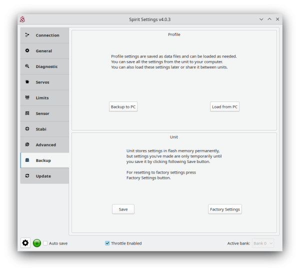

5.9 BACKUP TAB
Here, you can save the settings to your Spirit unit before powering off, you can also save the settings to your computer here, Should you need to reload them at a later date.
Profile
This section allows you to Save and Load complete settings of the unit to a specified file. If you have more than one of the same model, it is not necessary to carry out a complete setup again, just load the stored settings easily with the Load button.
Unit
Any changes to the configuration can be saved at any time to the internal flash memory of the unit. To put all settings to a factory defaults, click Factory Settings.
Info.png Remember to save the settings each time you want to store the settings permanently. You must press the Save button. Otherwise, the changes will be lost after the Spirit FBL unit is turned off.
Bank Switching
In case that the Bank Switching is enabled, you can save the settings from single bank or even all banks. To see the differences between Banks you can use Bank Comparison feature.
