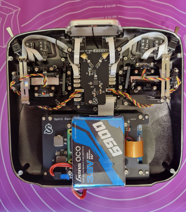

Spirit Wave Radio is equipped with LiPo battery - GensAce 6900 mAh 3.8V.
Warning.png It is prohibited to use battery with a different nominal voltage than 3.8 Volts.
Warning.png Always disconnect battery before changing any radio wiring or changing a components.
Warning.png Do not expose electronics to a high moisture or high temperature.
Battery is installed at the tray with a velcro tape. It must be precisely positioned to avoid a contact with a nearby parts, wrong positioning will not allow mounting of the back cover.
Special care must be taken at the battery cables during Radio Chasis closing. Pay extra attention to not touch any electronics part with a conductive tools.
Operator is responsible for careful placement of the cables to avoid damage.

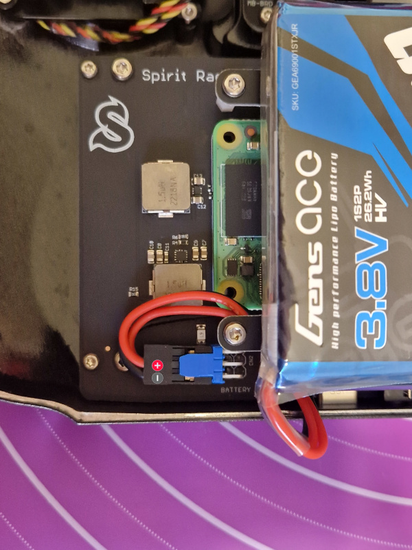

1.1 Battery Connection
Battery has two leads that must be connected to the Radio with a correct polarity.
Warning.png Shorting a leads or routes at the PCB could cause fire!
