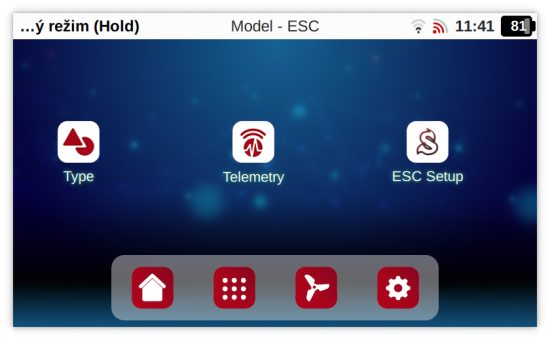

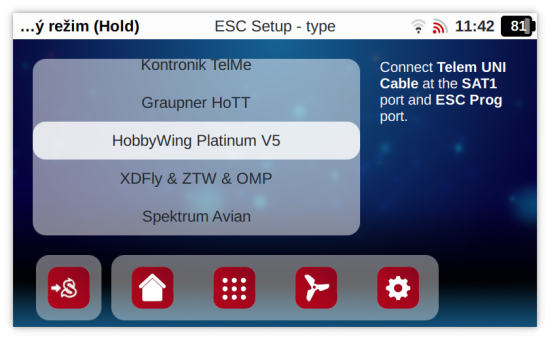

For enabling the Integration you have to enter Model - ESC - Type page.
After Saving the settings you can repower the Spirit unit and from then ESC Integration is ready to use.
