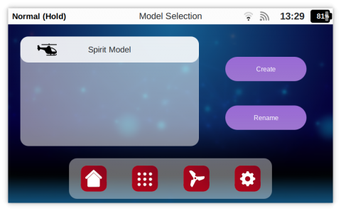

1. Go to Main Screen by tapping at the Home icon from where you can enter Model Selection menu.
2. Tap at the Create button and choose Yes.

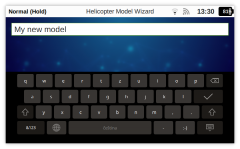

3. Then select Helicopter or Plane and enter Model Name if using Spirit W1.
Info.png By default Spirit W1/W3 units are preloaded with Helicopter firmware. You can flash Spirit Aero firmware for free at any moment if you plan to use a plane.
