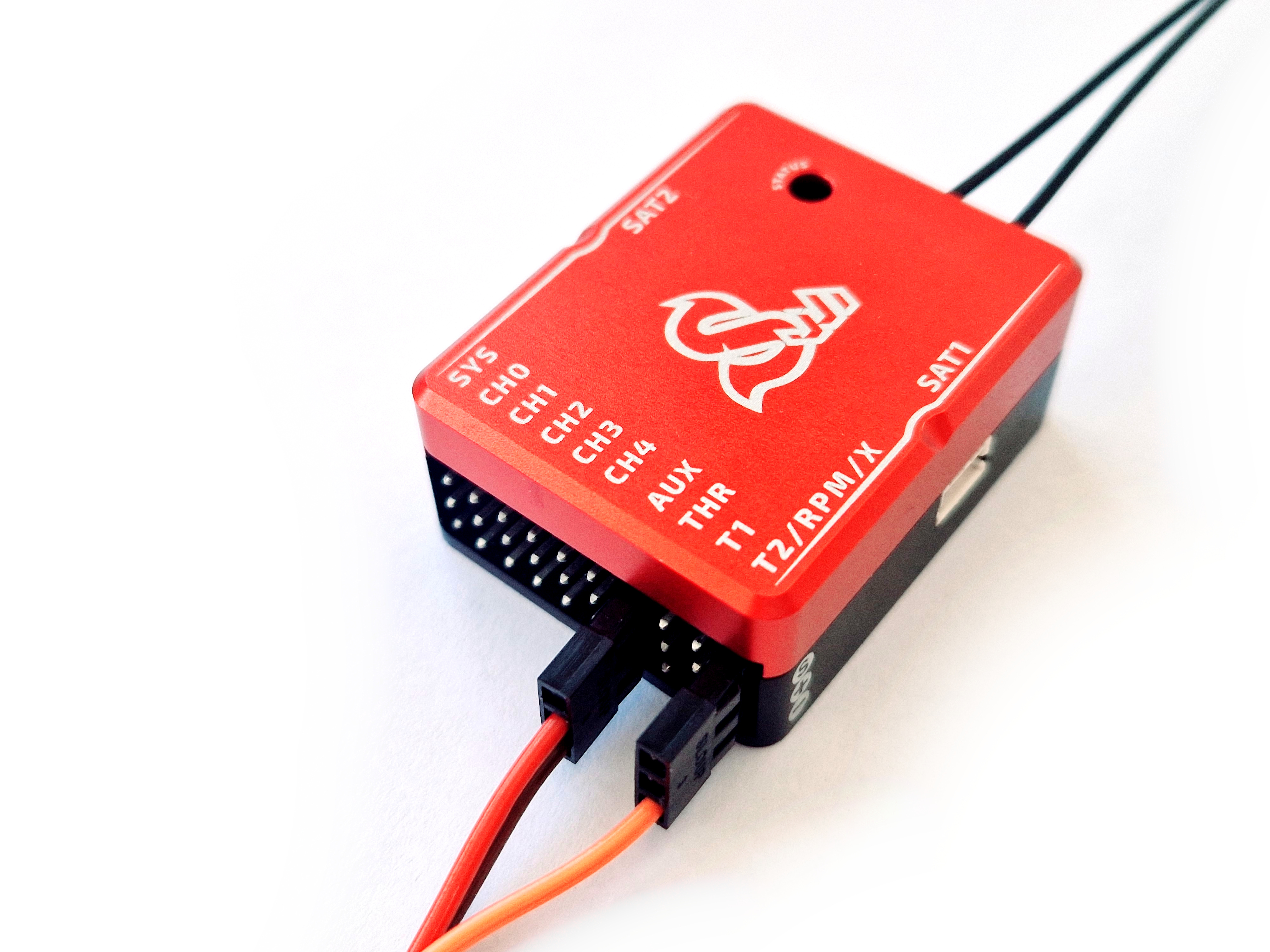

Warning.png Spirit W1/W3 is equipped also with X pin at T2/RPM/X port. This pin is used internally for communication with built-in receiver. When using Spirit RX receiver nothing should be connected to X pin.
1.1 Telemetry Sensor Wiring
1.1.1 T1 port
Connect Sensor or Expander cable directly without any change.
1.1.2 T2 port
Connect Spirit Sensor cable in so that RED/BROWN wires are at the AUX port (or any other free powering port) and ORANGE wire at the bottom T2 pin. In case of lack of free ports, please use an Y-cable.
Info.png Original connector must be modified so that two servo connectors are used.
