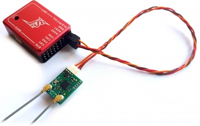

SRXL2 is new telemetry enabled receiver technology from Spektrum that is able to carry all channel data and telemetry at the same time. This mean that you will not need to connect anything else except one cable.
By using the SRXL2 adapter you will not need any additional modification to the receiver. Cable is available in our E-Shop.
Info.png In case that your SRXL2 receiver is not bound yet, you can do so by pressing embedded Bind button. Press the Bind button at the receiver during power..
SRXL2 receiver SRXL2 adapter cable must be connected at the JST socket in receiver.

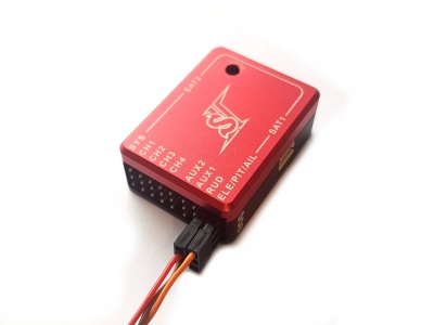

Spirit unit Other end of the SRXL2 adapter should be connected so that Orange wire is in the AIL pin. Powering plug with Red and Brown wires in the RUD port. (see the photo)
SRXL2 receiver Spirit 2 unit
