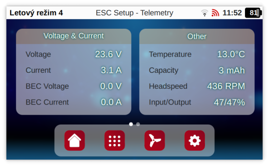

4 Telemetry Screen
ESC Telemetry data can be displayed at the Model - ESC - Telemetry page or added at the Main Screen as Widgets.
